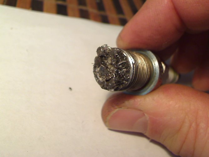

Smashed Spark plug...

So i pulled out the right spark plug and looks good... preparing to take apart that side and have a look inside..
go to pull the exhaust off and ...... the allen bolt for the clamp holding the exhaust pipe to the muffler strips out! Damn! Nothing is easy!

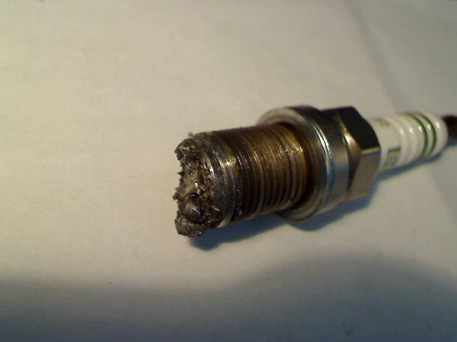

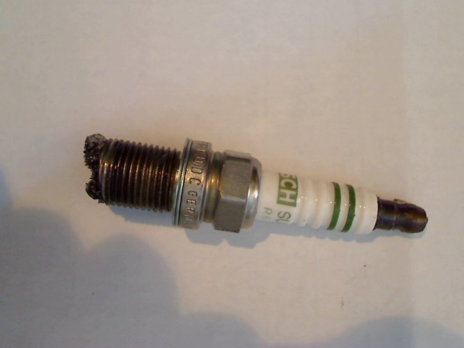

So i cut that bolt off so i can take the exhaust pipe off, go around to the other side to take off the nuts holding the exhaust on..and I think " well , might as well take out the other spark plug and check it...
Plug is hard to get out...thought i might have cross threaded it putting it in, but i dont remember it going in hard... get it out and....
WTF!?!?
In addition, i probably stripped the plug hole threads now!
Also the top blew off of one of my spark plugs( not sure which side) in 2015 on the way back from dallas... towed the bike back home...took apart the engine and everything looked good inside the cylinder
replaced the plugs and rode it since then...9K miles

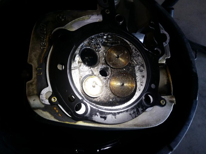

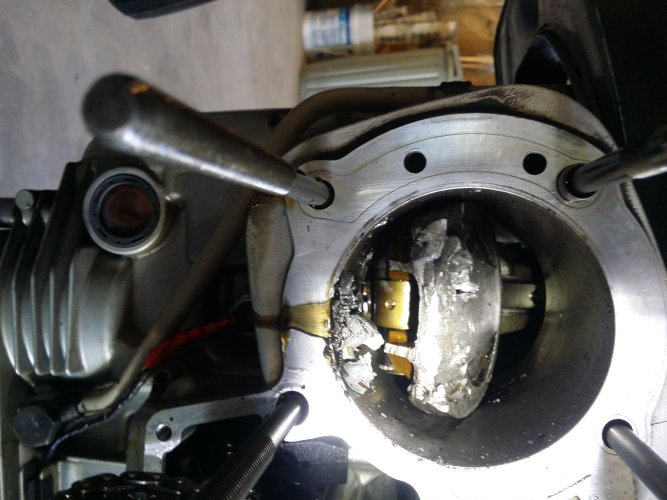

I decided to open up the bike today...removed the exhaust pipe and metal dropping out..
loosened and backed off the throttle assembly... more metal
Tried to TDC the engine to start to take off the head , and unable to turn the engine only a little to center it...tried front with a wrench and also bumping the wheel.. nope
Looked in the spark plug hole and it did not look pretty..something has shattered..ugh!
So i can not TDC it, so i guess i should just zip tie the timing chain as is and go ahead and open up the Cylinder head and see what mess is inside..
Was looking for a conformation of this before i proceed ...especially with me unable to TDC the motor..

I don't always save the TDC when I open one up. The BMW repair manual is very clear about what correct timing is, and for me it's not that hard to set it from scratch later on. Just go for it and we can get you to TDC at the end of it.
