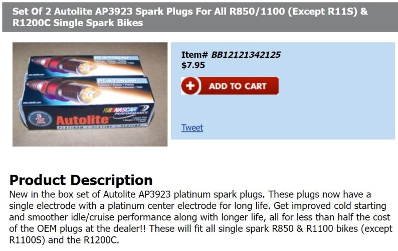

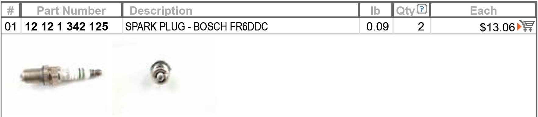

Here are the bosch plugs as shown on the Max BMW parts fiche for the R1100RS. Next are the new bosch and autolite plugs for the R1100RS from BeemerBoneYard. I did not see Iridium plugs on BBY for the R1100RS.
