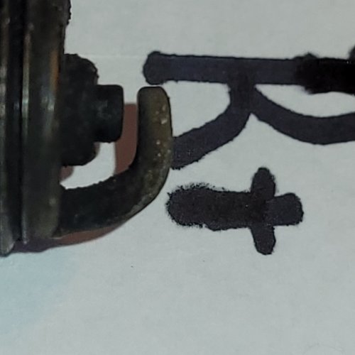

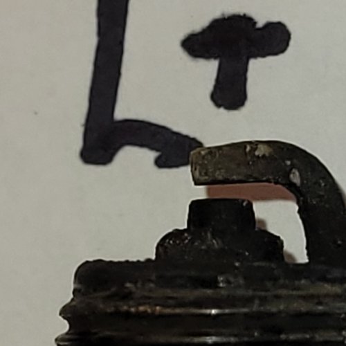

Swapped left and right plug wires to make sure both coils were working and the left side still fired and ran the engine. Using my hand and an infra red thermometer Left side head gets hot quickly Right side barely gets hot. Pulling plugs after running a couple of minutes, right plug is warm, left is HOT. My feeling is right side heat is coming from hot exhaust from left side.
Looking at PLUG photos, the right might be igniting intermittently.

Left coil is top plug right, left plug lower. I will try switching it around. I did put my timing light on left side upper plug wire and light appeared to flash/strobe normally but the timing marks were erratic as strobe flashed. Hooked light on right wire and strobe light was noticeably erratic.This makes me think that there is an issue within the ignition system. Hopefully not in the little black box. I will be swapping out coils with spares that I have, as well as wires, if I have some.
