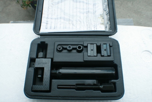

When you swap the chain, I can't recommend the RK chain breaker kit highly enough. It'll press the old pin out of a link easily and when you install the new chain, you'll be able to rivet it properly instead of using a master link, which I've seen ejected a few times during my riding career.

The only unfortunate thing, I already ordered before I saw your post! I got the Motion Pro PBR tool instead of the one you recommended; hopefully I'll have good luck with it, came recommended by a mechanic friend so.. Finger crossed! And yes, the new chain is a rivet style link, not the "clip" (is that what it's called??) link.

Just re-read @omega man's earlier posts and he mentions the Motion Pro tools. That's the one I have too (PBR) and it has worked fine for me. One additional tip - if you haven't done it before order a couple extra master links. I use it so infrequently since chain life is pretty good these days that I always have at least one extra master link in case I get too ham-fisted with it and over-peen it.
