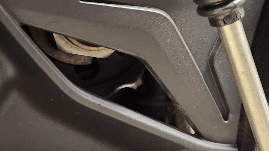

Looks good to me. No hooking or sharpness. The teeth all look the same.
If you were thinking the slip you mentioned, I don’t think it is the chain. Chain slip is usually rather violent and causes a bucking sensation.

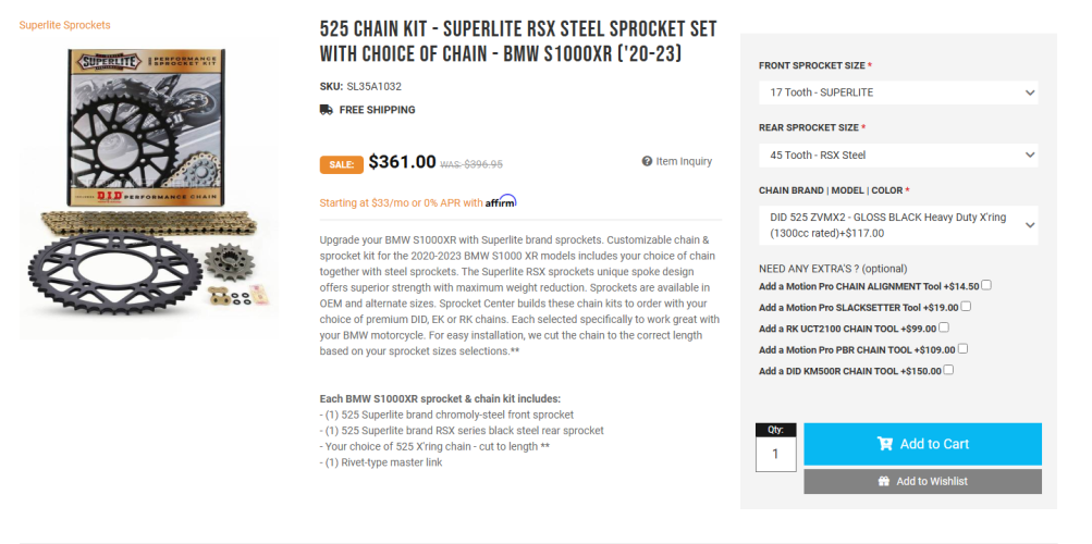

I may do the chain as preventative maintenance, it doesn't look bad to me, but 22K out of a chain seems like a lot, no? Anyone happen to know stock front/rear sizes of the 2022 XR off the top of their head? I'm thinking it's 17/45? Any reason to go with a rubber dampener in the front sprocket (seems to be offered as one of the options on the kit linked below)?
Here's what I'm looking at:
That ought to do it. Seems like, if I remember correctly, over something like 70hp generally requires a rivet style master link. I can recommend doing a test run on doing a rivet style master link. I have never used the proper tool on that style ML but have peened the links closed.
O-Ring chain is a bit tricky to hold together when a clip style ML is used. It may require some of the chain specific tools to help you get it together. I think the ones I have are by Motion Pro.

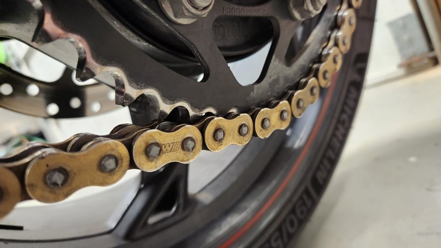

Some video of me fooling with the chain, love to get your comments/suggestions. I don't want to color opinions, curious what you/others think?
At 1:30 there appears to be 2 links with a slight kink??
If I put my hands on them I can flatten them back out (with just a bit of force). I think it may be because it was cold, I use a wax lube on the chain and when it's cold, stuff gets "sticky". That said, the entire chain looks a bit "kinky" to me when you look at it around 1:45 or so up at the top. I'm not sure if that's normal or not?
