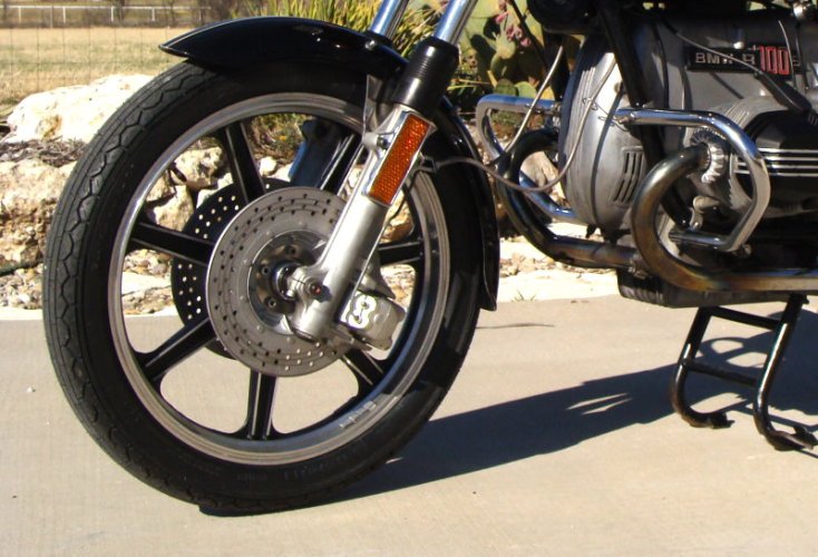

So, not to spark a tube/etc debate on this thread, but I'm not near my bike and was wondering..
Are the Lesters the same size (19 front / 18 rear) as the spokes? Are they supposed to run tubes? Is there anything I should know about size-wise?
I am thinking of getting:
Front:
ME880 Marathon 100/90 19 and
Rear:
ME88 Marathon 120/90 18
They're what I'm running on my spoked R75, so they'll work on the Lesters, too, right?

Yes the Lesters are the same as the spoked wheels in rim size.
Yes they are supposed to run with tubes. I don't think that tubeless tires were invented yet when Lester start casting this design!!
Yes those Marathons are what is wrapped around my Lesters, they work great.
Lesters
My Lesters came with valve stems for tubeless tires, however I elected to run tubes. Just my preference. / RB
