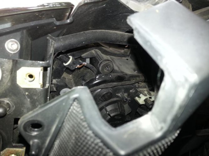

Headlight bulb replacement success
After bleeding from the knuckles, I decided to step back and look at the instrument cluster on my 06 RT. I noticed that the screws are T25 torx. I removed them and gently pried open the surround on the cluster and viola! Successful access to both sides for the headlight bulbs. Try it !
