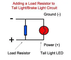

  • The examples I've seen install instructions, placing the resistor between the power and ground wires. (Example, below, though he's describing an LED tail light; same principle)

Partial answer - A 6ฮฉ resistor in a 12 volt circuit will pull 2 amps, which "may" be in the range that the computer expects to see; this resistor will eat 24 watts of power, so a 50 watt resistor is a good choice. They can be physically placed anywhere that's convenient, out of the way, and allowed some airflow to carry the heat away.
