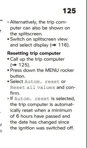

While I feel your pain and I am very sorry that other than the advice all ready given would be my thoughts. I must thank you for bringing to my attention the difference between a long and short press of the turn indicator switch. I am new to the old turn indicator switching. I really miss the right left thumb switching. I am now on my second read of the manual.

My boxes are "checked" when they are on! Quite different looking than post #1. I don't think you have it turned ON. Mine is checked and OFF next to the right arrow. Long press of turn signal puts them in "timed/distance off mode", short press turns off after bike leans back up after turn.

Out of curiosity, are setting still good in the next morning- key on, and then change after the start cycle?
No, they reset with the bikes computer after sitting for six hours. When you power up the bike everything is reset, before starting the bike.
