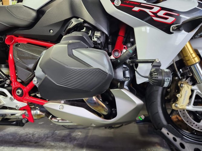

Just so you know. Those Machineartmoto valve cover protectors will prevent scrapes and damage on tip overs. But, they will pretty quickly wear through the paint and do not preserve them in pristine condition.
They didn't wear paint on mine but they did stain them permanently.
What paint? I have them installed and they're not painted. I've dropped my GSA a few times, (it's an adventure bike afterall) the crash bars show some wear but the covers are still fine.
He's talking about the paint/powder-coat on the BMW head covers.
We had them on our R1200RSs for 58,000 and 54,000 miles and the coating on the head covers stayed in good condition.
When I took the MachineartMoto covers off for valve checks I would clean the BMW head covers good.
Ah, ok makes sense.
No paint wear on mine either
