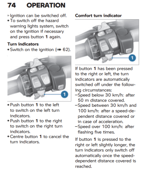

From My Post in the R1250RT forum:
This is interesting... I had set this up and went to the dealer to ask why it's not working, we went into the settings and it was not checked! Thought it was but the logic is misleading and I thought I had set it up earlier properly?!? Now I know I'm going bloody psycho mad! Haw. I've been riding a 1985 K100RT since new with over 300K miles on the clock. It's Auto cancel turn signals were brilliant! See what the owners manual says... I've petitioned BMW to consider this as an option since they are rewriting the SW. I think they use the on board AHRS sensor that senses lean angle to do this function, a lot more complicated than what they had that worked brilliantly a long time ago!!
About 15 years ago, a very experienced airhead rider got into a pretty good accident when someone pulled out in front of him after he was absorbed in riding and forgot to cancel. He said after that he just didn't use them anymore. I don't agree, but maybe if I had survived after something like that, I may agree as well on that :fix".
In my opinion, this is should be a safety recall given how worried BMW about safety as this is a safety critical item in my opinion. It should work as the manual states....
My bike 2024 R1250RT - Purchased in late Sept 2024...
1985 K100 manual no software upgrade for this and it works since 1985....
"The left or right turn indicators are cancelled automatically after a certain time or distance if this is not done by pressing
the switch :
@ after approximately 10 seconds at main road speeds — above approximately 30
miles per hour or 50 km/h, or
@ after approximately 210 m (690 ft) in
local or slow-moving traffic.
