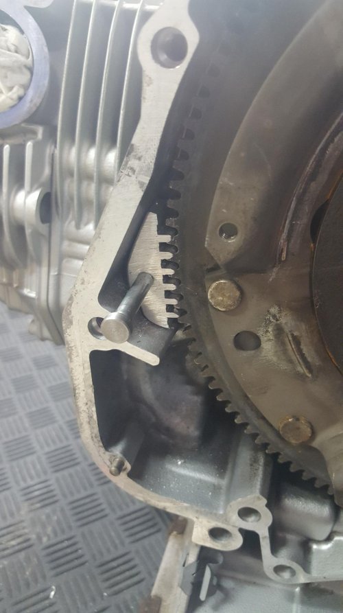

This is the tool that EME sells to fit the R1100s as well as others. Thinking it was maybe slightly too big, I inserted an hex key way smaller just to see if I could find it...still didn'tBMW-TDCpin-1.jpg

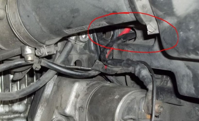

So discovery #1 there are two holes that open into the fly wheel. one here
And one waay up here blocked by the airbox impossible to get to without dismantling the battery box, abs pump just to remove the airbox ...guess which one is the one that you must insert the locking tool in? Yeah this one
So what to do...heat up a bolt and from the inside of the airbox melt a hole inline with the engine hole so a bar can be sent through the hole from the airbox...then find a rubber plug from ACE to plug the hole.

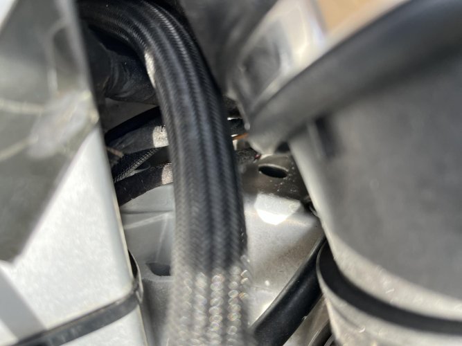

Sorry to be a week late with this. When you get down low and look forward at the starter motor, there's an obvious hole visible. That's not the hole for the TDC locking pin. The correct hole is slightly higher and closer to the engine. If you already knew this, sorry for the duplication.
No problem, on my model bike, (2003 R1100s) the first lower hole is for one of the rubber posts of the starter cover. I used a bore scope to peer inside and finally found the actual hole for the locking tool, and yes it's way up there. Your bike has it easy, you actually have the space to use a tool. Mine has the airbox 1.5"-2" away from the hole, making it impossible to get to without removing the airbox.
BMW engineers ( at least 20 years ago) were dirt bags. IMHO
The 1100S uses this tool to lock the flywheel because of the airbox. The starter is removed and tool inserted.
83300401562 ENGINE LOCKING DEVICE 0.05 1 $37.32
I made my own out of aluminum
