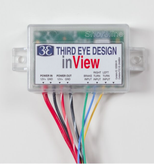

Out of curiosity, what is a InView tranceiver and what does it do?
It is a helmet mounted LED light that transmits the turn signal and brake light signals to the back of my helmet. It lights up very brightly and makes me more visible to drivers behind me.

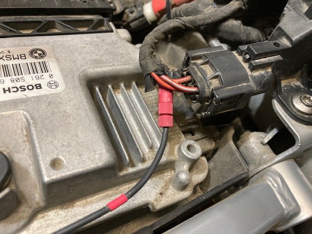

Want to add EzCan to my bike, what are these wires going to my battery??

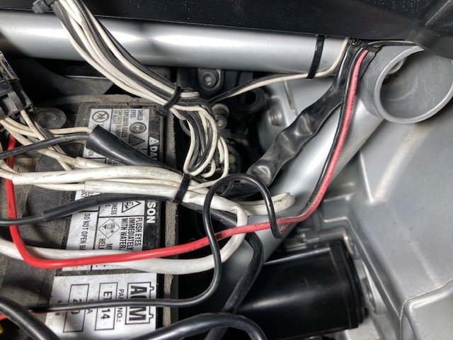

I'm finally getting around to working on my bike to add the InView helmet light transceiver to my bike. First I think I would like to put a Hex EzCan on the bike to make the Inview installation easy and to clean up some wiring from aftermarket Rigid Industries LED lights and PIAA horns that a previous owner had installed. It looks like some of the wiring from these lights and horns are connected to the battery.
I hope these pictures are good enough for someone to help me figure out what they are attached to before they connect to the battery. There is a set of red and black wires coming from under the gas tank. These wires are connected directly to the battery.
There is also a set of black and white wires coming from under the gas tank that are first connected to the wiring harness that says PIAA, and then go to a fuse to the left of the PIAA box. There is also a set of two black and two white wires connected to the PIAA harness.
There is also a white wire that appears to be hooked up to something behind the head light with a Posi tap connector. I'm guessing this is for the horn or lights so that they can be used with the BMW handlebar button.
So to summarize, there is one set of black and red wires, each wire is connected to the battery. There is also a set of black and white wire coming from the PIAA harness that is connected to the battery. I would guess that the PIAA harness is for the PIAA horns and that the black and red wires are for the LED lights. Can I take each set and hook them up to each connector on the EzCan? I could take the tank off to trace these wires but I'd rather not if I don't have to.
I will attach some pictures that I hope will help explain the situation. Thanks in advance. Mark

In the last pic, the PL5FB looks like a relay to allow the horn to be disconnected when the bike is not "on" and/or to allow direct draw from the battery when the horn button is engaged.
It could also be the same type of thing for the aux light - gets a signal from the tapped light wire which triggers the relay and then powers the light directly from the battery.
The PL5FB is a PIAA relay so I would assume it is for the aux lights.
Thanks. Can I connect those wires to the EzCan, since EzCan will take the place of the battery as the source of power?
You will need to figure out the signal vs power wires, and whether it's for horn, and how to maintain the control... other than that I see no reason not to. (I have no experience with the EZ-CAN...) I just re-read and see that the horn is PIAA.
And PG - the horn is a PIAA, the lights he said were Rigid Industries, so the relay is definitely for the horn.

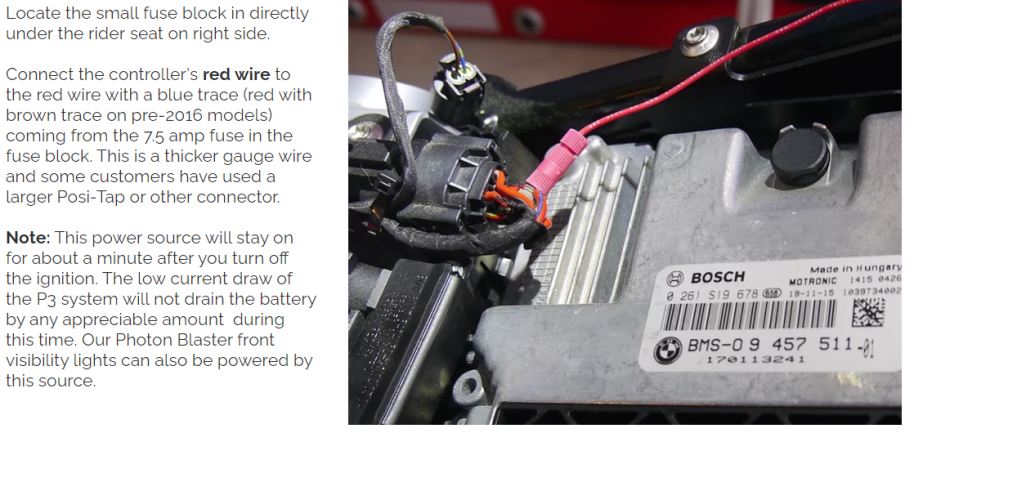

Red/Brown fused wire under riders seat: Power

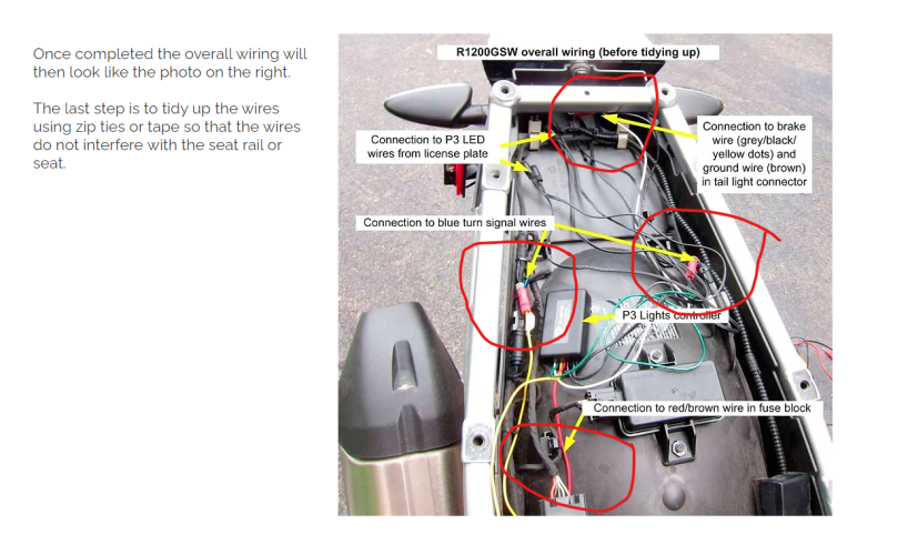

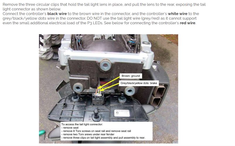

I removed the rear grab rail behind the passengers seat and rear carrier under the passengers seat. Then I removed the license plate holder assembly by removing two screws. Then I removed three clips holding the rear tail light to access the rear brake light wires.
I connected the Inview wires to the Grey/Black with Yellow Dot Brake light wire, Left Blue/Red and Right Blue/Black turn signal wires, I fastened the Brown Ground wire to the frame in a cross bar with holes in it between the rider and passenger seat. The Inview power wire went to the Red/Brown fused wire under the passenger seat. Here are the Skeene pictures:

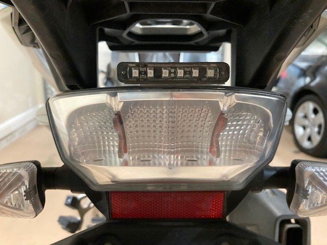

Here are three of my own pictures of the Invew Tranceiver located under the passenger seat, power wire connection to the fused wire under the riders seat and the small LED light that is on top of the rear tail light. The Inview tranceiver has a decelerometer and this LED light provides a brake light when decelerating without using the bike brake levers.
