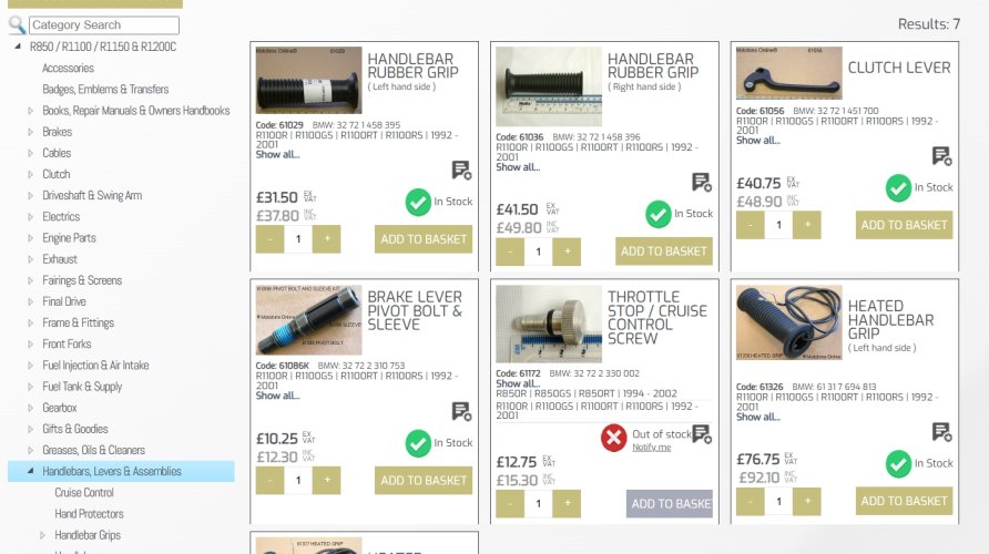

kbasa, how do I source the parts? go on Motobins and find some throttle housing? Then the screw is sourced from BMW? Tried to reread the posts but am confused.
Found this page on Motobins. Go to Motobins, select the R1100RS, then select Handlebars, etc.

Kurt has you covered right above. You need the new housing with the hole drilled in it and the screw, which are both available there. Use the part numbers on the first page of this thread to find the bits you need.
