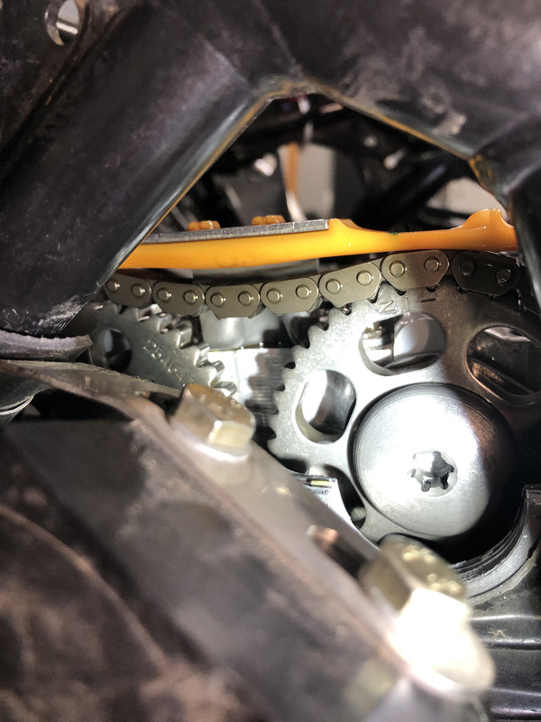

5F: Measuring sag
Several riders have noted that there is an excessive amount of sag in the chain between the two cam sprockets. Upon changing the cam chain, the sag goes away. Again, BMW does not specify any way to measure chain sag. This probably isn’t a perfect way of determining the need to change the chain, as the tensioner system should take some of this sag out while the bike is running.
See the two vides by Jocke:
Sag:
No Sag:

5F: Measuring sag
Sag:
No Sag:

Section 9:
Basic, Basic Process to change the chain:
[This will be documented later]
- Get to the valve cover and remove it
- Remove the clutch cover
- Rotate the motor to #1 TDC and lock the engine
- Remove the cam bearing plate
- Remove the cam chain tensioner
- Remove the intake and exhaust cams, thereby freeing the chain
- Cover everything
- Grind the pins of the old cam chain and slide out the pin
- Attach the new cam chain to the old cam chain
- Remove the TDC locking bolt
- Rotate the rear wheel in 6th gear; gently to pull the new cam chain around the bottom of the engine
- Make sure the motor is at #1 TDC and lock the engine
- Install the intake and exhaust cams, taking care to make sure you have the right timing
- Rivet the new chain’s master link
- Install the all the new guides
- Install the new tensioner
- Install the cam bearing plate and clutch cover
- Double check everything
- Pray to the motorcycle gods
- Pray to the gods you offended by praying to the motorcycle gods first
- Button the rest of it back up
- Pray one more time to whomever you’d like
- Start the bike up and smile at your success
Whoa - you read this far - thanks!!! Sooooo... what did I get wrong???
