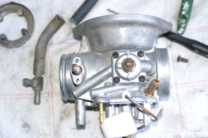

I'm working on the carbs and replaced floats, all seals and diaphragms. I removed the butterfly and my question is how much light to you need to see after I put back together?
To much?
Not enough?
Before
After
I used a can of Berryman carb cleaner parts, it does a good job.

The carb valve should close COMPLETELY! The less light the better. Check and see if the valve is in backwards, the edges are cut at an angle to aid in this and can easily be put on backwards. Carbs starting to look clean though.
There is a dot on the flap that points upward and out. Is that correct?
Sorry don't know about a dot but do know they have to close almost totally. I have sometimes left the screws loose and tried closing the valve and moving it until it is right, then tightening the screws.
I will check that again.
I'm guessing with that much light showing past the butterfly the engine will rev a good 2500 to 3000 rpm at idle. Anybody else have a guess?
with the idle adjuster backed away(no contact) the butterfly should close completely. loosen the screws and adjust it so(it has room for movement) DO NOT forget to peen the bf's screws after.. the dot on the choke(fuel enrichment ) shaft should be pointed towards the side with the large bump when the levers are reinstalled....

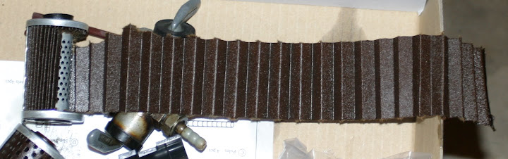

I also dissected the oil filter.
