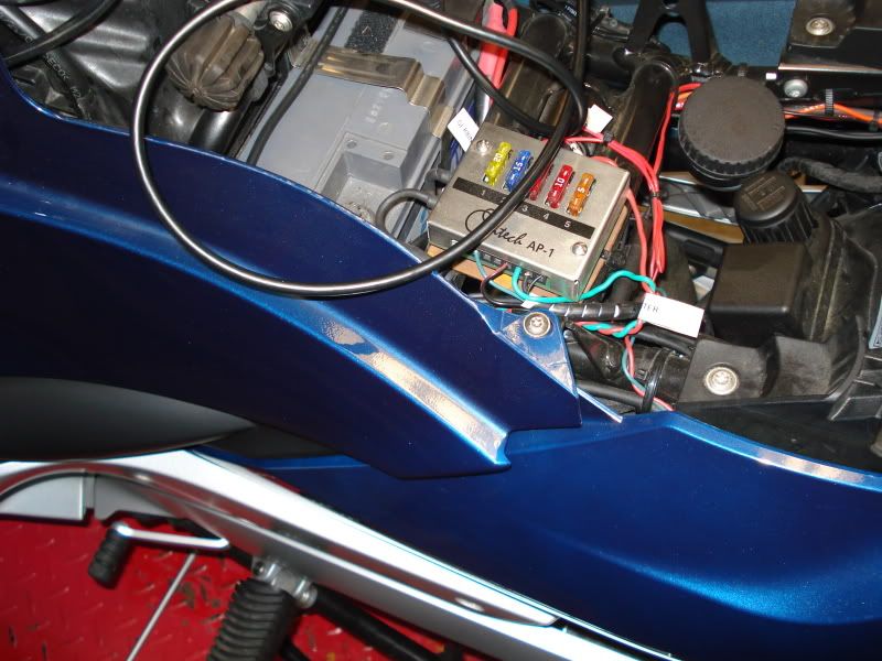

The 5 amp limit applies to most R1200s. I believe the RT has a 10 amp limit (RT owners correct me if I'm wrong). To get around it, many owners connect a fuze box to the battery and wire the accessory socket(s) to the fuze box. A search on this site will produce plenty of posts on how to do this.
Just buy an aftermarket socket kit. Easy as pie, just remove and unplug the OEM unit, insert the aftermarket unit (or BMW accessory kit) wire it straight to the battery with the fuse as close to the battery as possible, and you are done. Cost is about $20 and it will take 20 minutes to install.

dhgeyer, I had the exact same problem with my 08 GSA. It turned off when I had my heated liner on, no warmth! Anyway, upon investigation I found out that stupid accessory plug is only 5 amps (almost worthless). So like Semper Fi, I attached a Fuzeblock FZ-1 ($79.95). Installed it under the seat on the tool box tray (I keep all tools in my saddlebag) along with my AutoCom. Now with the liner plug, AutoCom and Satellite radio, they all work off the Fuzeblock and problem solved. I had a 06 RT and recall both the front and back BMW plug worked heated liners. Go figure sometimes one step forward and two steps back.
I also connected a Fuzeblock to my RT, right on top of the battery and direct wired both my sockets to it. There are three nice benefits. One of course is that it will work for heat! Another is that it will work when the bike is off which I like when getting gas in cold climates. Finally, you can plug in your battery tender w/o worrying about waking up the CANBUS system, etc. Just plug it in and go.

I also am not outraged. BMW branded heated clothing (I had some) works with the RT outlet, not overdrawing the circuit. And yes, it is mundanely simple to direct wire the outlets to the battery, either via a fused link or a "fuzeblock" or the ilk.
No use making a bigger deal of it than it is. A pair of wire cutters and a soldering iron and you're good to go!
