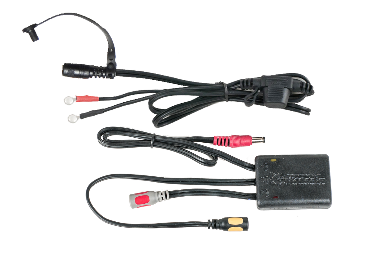

I think you have misunderstood the Heated Layer Shirt pockets. Notice that the diagram below does not show the any of the three pockets holding the remote control. The pockets of the Heated Layer Shirt are small because the only thing that's supposed be in them is the wires when they are not in use. The whole point of the small wireless controller is not to fit in that small pocket, but to be easily mounted where you can see what you're doing, and what you're riding toward, while you adjust your heat. In the cockpit shot of my S1000XR below, you can see my remote control mounted front and center where it is easy to adjust, double secured with 3M Dual Lock and a lanyard/carabiner combo. The corresponding receiver is under my seat and my wires are tucked behind my left side panel until I bring them out for use.

OK, I'll be more general and more complete this time.
The Heated Layer Shirt (HLS) pockets are not intended to hold anything other than the plugs that are part of the shirt, i.e., to hide and store the plugs when not being used. Note in Warm and Safe's diagram below, the (1) Dual Controller or Receiver and the (2) Dual Transmitter (if applicable) are pictured as being outside the HLS.
That said, this diagram is misleading in two ways:
(1) There is no HLS specific diagram (which would show both plugs B and D coming out of the same HLS side pocket)
(2) This diagram suggests you should plug the HLS directly into the Dual Controller or Receiver. Given the shortness of the wires involved, this would leave the Dual Controller or Receiver hanging from the HLS, banging against the rider's side and unsupported except by the friction fit of plugs B & D.
Fixing this is easy: First note that this applies to using a Dual Controller or a Dual Transmitter/Receiver Pair. The Dual Controller has the wires and knobs attached to a single box that has to be mounted where you can reach both the knobs and the Power Out cables. The Dual Transmitter/Receiver Pair has two boxes, a Dual Transmitter with knobs that you can mount anywhere you can reach the knobs and a Receiver that has to be mounted where you can reach the Power Out cables.
On Bike 1, I use a Dual Controller. I use 3M Dual Lock to mount the Dual Controller on the left side of my fairing where I can easily reach the knobs without taking my eyes off the road by feeling with my left hand and where I can have the Dual Controller's Power Out cables tucked under the fairing when not in use or on top of the fairing when in use. I have the Dual Controller's Power In cable wired under the fairing panels to my bike's battery via the a fuse-protected switched-power relay that provides power only when the ignition is switched on.
On Bike 2, I use a Dual Transmitter/Receiver Pair. I use 3M Dual Lock and the Dual Transmitter's Lanyard to double secure the Dual Transmitter to the top of my GPS prep mount where I can easily make adjustments while keeping my eyes on the road. I use cable-ties to secure the Receiver under the left side panel of my bike wired to my bike's battery via a fuse-protected switched-power relay that provides power only when the ignition is on. When not in use, I tuck the Receiver's Power Out cables under the left side panel. When in use, I pop the left side panel partially off; pull the Power Out cables outside the left side panel; and pop the left side panel back into place. This puts the Power Out cables directly below my left thigh when I'm sitting on the bike.
When I don my HLS, I have two each two-foot DC Coax Extension Cables (Warm and Safe SKU 71000260) that I plug into the HLS plugs B and D. Just before I mount my bike, I plug these extension cables into Bike 1's Dual Controller Power Out cables or Bike 2's Receiver Power Out cables. With the two-foot extension cables, I have enough slack to mount and dismount the bike as well as enough to move around and stand-up in the seat.
Hope this helps.

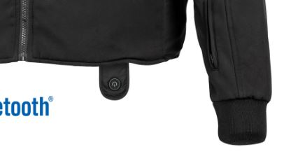

The controller on the Tourmaster gear is a 4-way button attached to the gear!
That looks like it would be difficult to get at underneath a 3/4 jacket like my Darien, unlike a controller mounted on dash or tankbag.
And I'll bet using your phone as a controller is much easier than using the 4-way button, but at least it's there for backup. (y)
