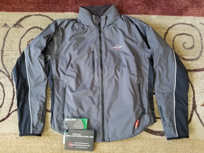

I did it, I drilled into the plastic today. I started riding in Colorado with a heated vest and the grips and seat are great but what about my vest?

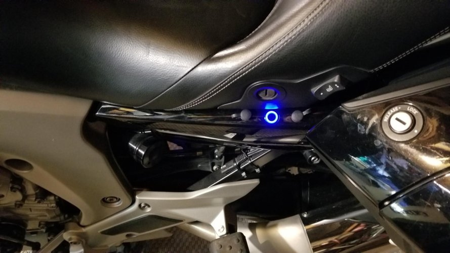

With cables plugged in, the ring around the button is blue and will be on when it has power to the garage door controller.

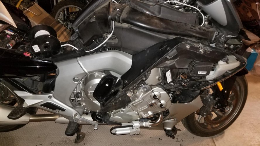

Good progress, both heated ports are setup and working with a status light for the back port. Garage door switch installed and wired up and installed the dashcam, overall everything fit and I still have a "little" room left under the seat.

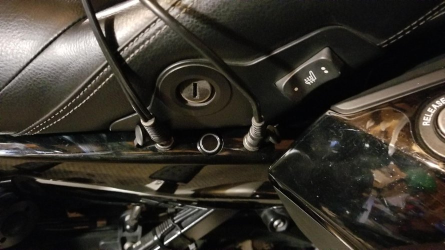

Installed with garage door button active:

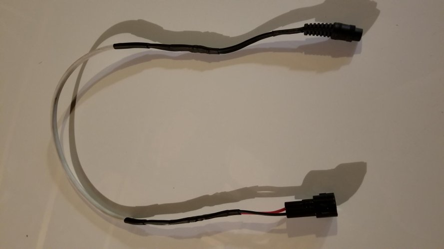

One of the wiring harness made for the heated gear:
