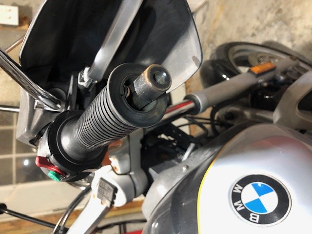

Hello everyone, while performing annual maintenance and replacing the bar-ends on my 2000 R1100R (it had chromed ones that were peeling so picked up a pair of used standard black ones from Beemer Boneyard) I made what I think is an interesting discovery. The grips are wired so I'm assuming these are heated grips, however from what I can tell with Google Image searches the switch for them, which would be the left of the three switches between the bars at the top of the steering head, is not labelled as such and does not do anything. I can press it down in either direction with some effort, but it doesn't click into either position. I haven't yet removed the fuel tank to trace the wires coming out of the grips as I wasn't planning on removing it this winter (no need to otherwise), but at this point I may just out of curiosity (it's not like it's difficult).
So, my question is, am I possibly just a switch and maybe a fuse or a relay away from having factory heated grips?! I was looking into Oxford heated grips as an option earlier this winter but picked up a pair of Hippo Hands instead to see how I faired with those before I bothered with aftermarket electronics. Where available, I'd prefer the factory option as long as it's not prohibitively expensive.
Below is a pic I took of the wiring in the grips: if anyone can confirm for me that what I'm looking at are indeed grips that are wired up and ready for heat I'd greatly appreciate it! This is my first post to the MOA forums, I've been meaning to do an intro post for myself for over a year now after I bought this bike in the fall of 2018 and enrolled as a member but just haven't got around to it; I sit in front of a computer all day at work so doing so at home is typically the last thing I want to do at home (I'd rather be wrenching or riding!).

You do have heated grips.
It is most likely the switch. Looking at the rusty screws beside the switch, I can surmise the bike has sat in the rain for a while.
Those switches get sticky over the years in weather and won't operate.
They can be carefully marked/disassembled, cleaned, contacts polished, and greased with silicone grease.
Many times the internal detent spring will be rusted in it's guide. It will need to be loosened with WD40 etc.
On rare occasions you will need to source a similar spring from aftermarket if too rusty.
Do the job over a white terry towel so you don't lose any internal parts.
I've fixed lots of them with good success.

This is great news, thanks you! I’ll definitely be refurbishing the switch in the near future. This bike had 126k miles on the clock when I bought it so it definitely wasn’t a garage queen, I do think it’s seen it’s fair share of the elements over the years.

I can confirm that it's definitely a real switch that's wired up, it has just failed and is in need of TLC. The labelled had worn almost completed off or faded: under just the right light and at the right angle I can I think I can make out the heated grip symbol, but it's very faint, hence me not realizing I had them!
