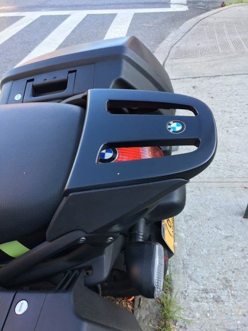

I have a 2004 R1550 R Rockster, with the attached luggage rack/grid. I've been looking around and trying to figure out which OEM top case will go on this rack. Can someone share the proper part number? It seems that the 22L or 33L top cases might work, but I don't want to get the wrong item. I am looking for the BMW top case, not an aftermarket one. Much thanks.

It exist, they are rare, I have one. I read on another forum it was an over $600 option from BMW, so not many people bought them. The one top case cost as much as the two side cases.
The part numbers inside the lid are as follows:
Deckel: 71.60-2 337 222
Unterteil: 71.60-2 337 223
Abdeckung 71.60-2 337 205
I think those are for the lid, the bottom and the mechanism.
