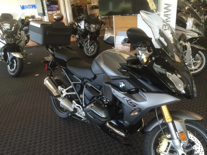

The Vario top box for the Wethead years will fit the rack on a R1200R/1250R and R1250R/1250RS rack.
The R and RS have the same rack.

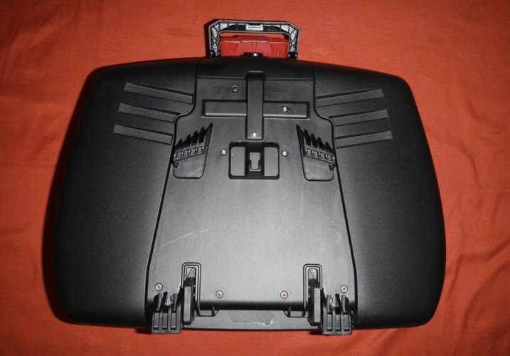

The 49 liter S1000XR top box will fit with a minor modification. There's a small bump on the bottom of the case you need to remove. I'll try to find a picture showing what has to be removed.
This box cost about the same as a RT box.
