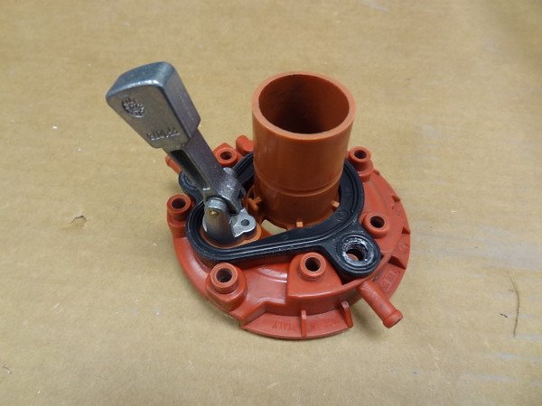

This shows the rollover valve on the R12GS
You can see on disassembly that the vent orifice is small. Maybe it could be enlarged while still keeping the valve, but I did not try. That would be one way to reduce the vacuum level in the tank and speed up the fluid flow.

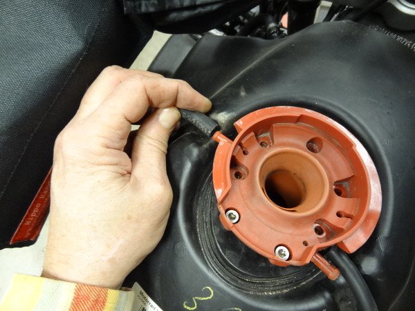

With the valve removed the fill neck was reinstalled. The thin vent hose was replaced with fuel injection hose...

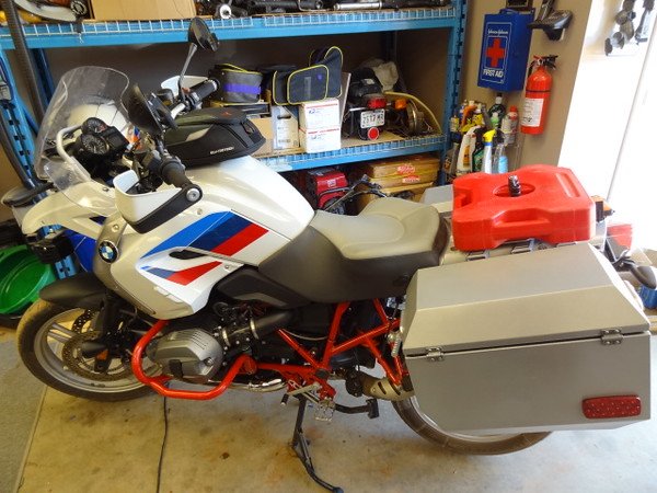

Finished installation of aux. tank. It has two (redundant) NHRA approved rollover vent valves in it.
Before the permanent auxiliary tank I used a RotoPax, but I would not have attempted to plumb it inline...
