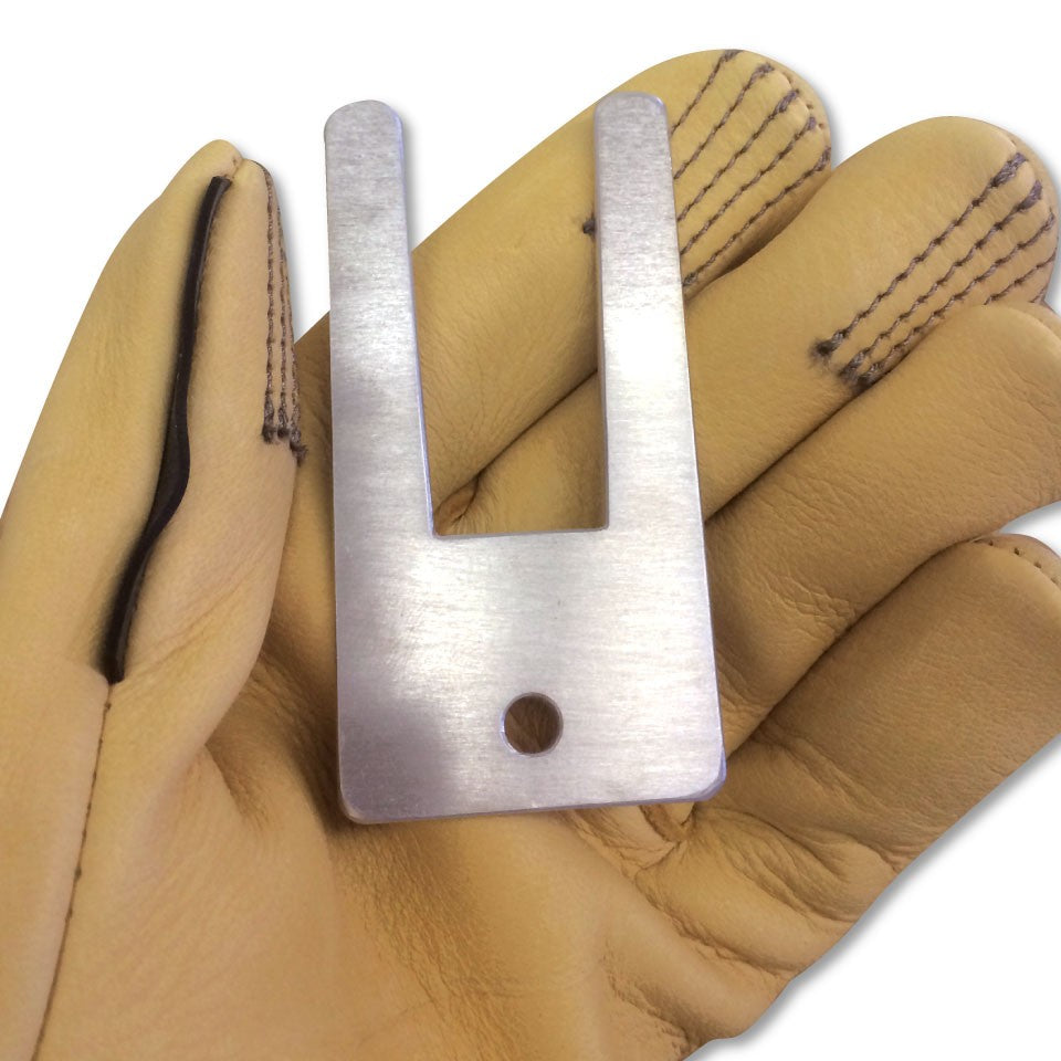

The solution to the “California Condom” at the gas pump:
:):wave
