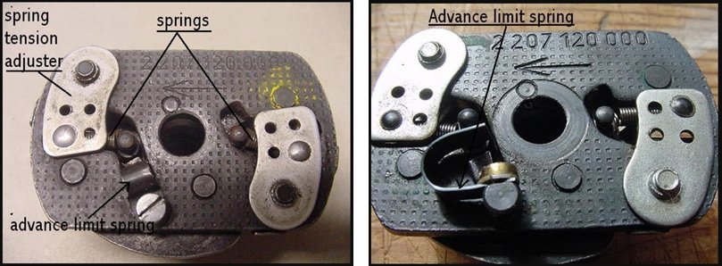

But my concern is mostly with where the timing is at full advance. So, I got a toothpick and propped out the advance weights to simulate full advance. I can do this because I have removed the small spring that was originally connected to soften the rate of advance. I have the later advance unit with the spring on its side, not the breakage prone "question mark" spring. In place of this spring, I installed what has been deemed the Caro stop screw. I don't have a good picture of it, but it acts as a hard stop for the advance unit weight movement. Years ago, I bought this screw from Bench Mark Works...not real sure of the size or dimensions of the screw. If you don't have this configuration, then this way of setting the timing won't work. It looks like this configuration but in my case, I removed the spring. Below are pictures (from Duane Ausherman's site) of two styles of advance units...the one on the left is the older style and the limit spring was prone to breaking...the one on the right (which I have) has the limit spring placed on its side. I removed this spring and put a screw where the brass colored head is...this is the hard stop to my advance.
