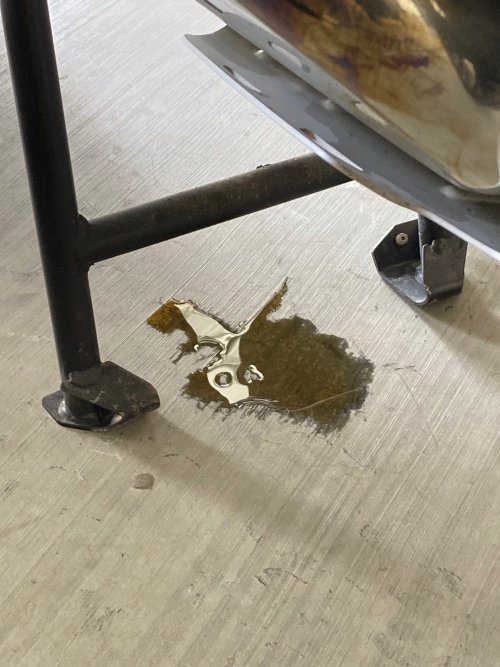

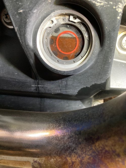

Had my 2023 R1250 GS into Iron Horse BMW in Tucson on Saturday (trailered down 225 miles from Prescott Valley). They are closed today, so I ask in MOA first. They did the 24k service. Bike bought there and always serviced there while under warranty. Only rode it 30 yards from their back lot onto my trailer and then 20 yards from the trailer on the street into my garage on Saturday night. Parked it. When I came back to house after going to post office today I noticed oil below. And oil sight glass shows a bit down (I know this is not a problem for the engine, but every other time they service the oil is at top of red ring). They also said the Cardan failed the test/inspection and they replaced the Cardan shaft. You can see a drop of oil at back edge of lower engine guard. Assuming they take the lower engine guard off to change the oil, it would seem this leak must be coming after they put it back on. I feel no oil leak at base of oil filter. I will remove the lower engine guard and take a look. Crackcase drain plug or front end of Cardan shaft area?IMG_3496.jpegIMG_3499.jpegIMG_3500.jpeg

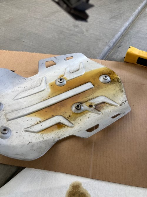

R1250 GS Oil Leak after Service Update
As you can see from photos, oil in belly guard and drip from drain plug. I almost was able to open the plug with my fingers. Took the most minimal pressure with my rachet to open it. Obviously not torqued to spec.
It is a good thing I was trailering it back the 225 miles to home and not riding it.

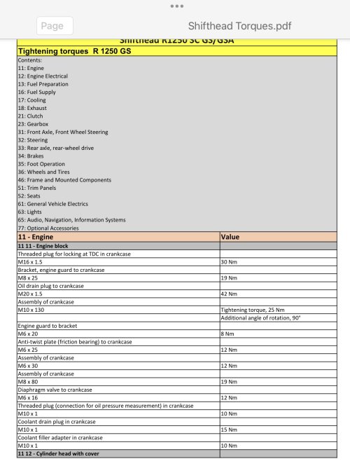

Shifthead Torques shows 42 Nm for oil drain plug to crackcase for GS. Does this look right to you folks?

Do you know if the torque spec 42 Nm on the chart is correct? So I can retorque it. Do not want to over torque if the 42 Nm is not accurate.

That Is the same torque value shown in the Wethead service dvd so that would suggest the value on the 1250 spec sheet is the correct value. I’ve not had any issues torquing my Wethead drain plug to that value.

First and foremost when the engine oil level is at the top of the red circle the engine should be at operating temperature, if the drain plug was not torqued properly or over torqued could be the issue, reusing gaskets is not a good idea

Yes, I am aware of oil levels versus operating temps. As I mentioned in my first notes I only rode the bike 30 yards from the dealer parting lot to my trailer and 20 years from my trailer to the garage 4 hours later. So the bike never got up to any operating temps. And had it done so, with the oil expansion, I would expect it to be a bit higher. But the bike was sitting. the drain plug appeared to have only been finger tightened, I could it feel it starting to move with my fingers but given the oily surface I could not get a firm grip. Once I put the hex key/rachet wrench in and started to turn it moved easily. So it does not appear to have been tightened/torqued. I have only slightly tightened it and waiting to confirm that the torque value is 42 Nm before I do it.
