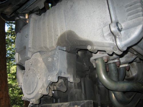

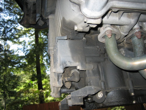

How do I fix this kind of oil leak?
Don't look at the oil filter cover.. I fixed that problem already.
This one is the hex bolt up in the corner at the same level as the manifold bolts behind the water pump.
I cleaned it up after these photos and it's dripping fresh oil.
Thanks in advance.
The bike was in for a new front tire and front wheel bearings today at
SJBMW and I had them look at the oil leak. The mechanic said he
tightened up the bolts.. said they were a little loose. Looked at the
area after I rode home and it looks a bit dryer than the previous
drip. I think I'm going to leave it for now because I'm riding up to
the Canadian border on Wednesday to do some visa paperwork.

Stephen,
This is one of those "they all do that" - at least to some extent if you've ever had the bike lifted by the oil pan (like for a spline lube..)
There is no gasket on the top of the sump (which is where your drip is) - just a sealant. It can be damaged a bit by the weight of the bike when you lift it by the oil pan.
Your mechanic did the right thing - usually retorquing the sump bolts slows it down or stops it. The real fix - remove and reseal.

I think you said exactly the same thing to me some years back. :D
Ditto Dat leak
Same thing happened to me 10 years ago, same repair fixed it.
I lifted the bike last year from the engine (forgetting about what it did last time) and it did it again. Sealed it again and its dry. I now have a electric hoist in the garage that I can lift with in the future, so it wont happen again.
Tighting the bolts helped only for awhile in both cases for me.
