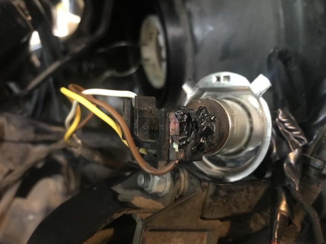

Getting ready for ride to Des Moines tomorrow and have no headlight the high beam indicator is on and stays on no matter what I do with headlight switch on left grip going out to start process to get to bulb, any ideas what to might be wrong let me know.
It’s always the ground in this case melted socket at ground pin, works now think I will fix it right before I go on long trip. Now I will have to take the cage, the big tent, large coolers full of beer food and ice etc.:dunno

If you want a non plastic headlamp socket NAPA LS6235 can handle the heat.
Went to Napa first did not have your # for socket all they found realy light plastic socket and a h4 bulb $28 so went to amazon got 2 pack 14 gage wire ceramic sockets ( 1 spare) $8 a heavy duty h4 bulb $8 and a 10 pack posi lock connectors $10
