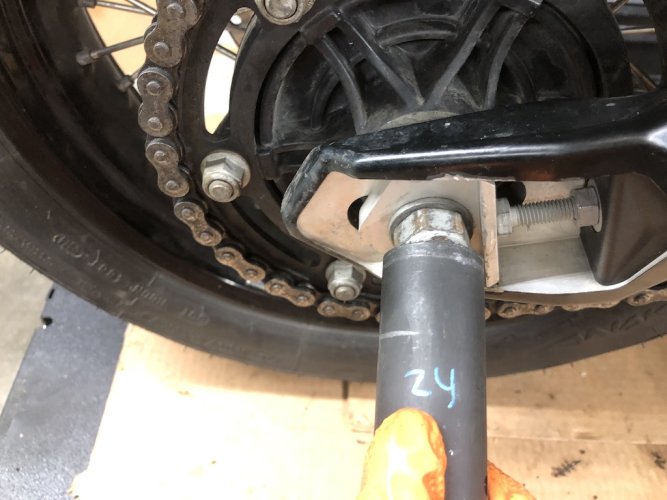

Once you have the proper chain slack, use your 24mm socket and torque wrench to tighten the axle nut to 100 Newton Meters (73.8 Foot Pounds).

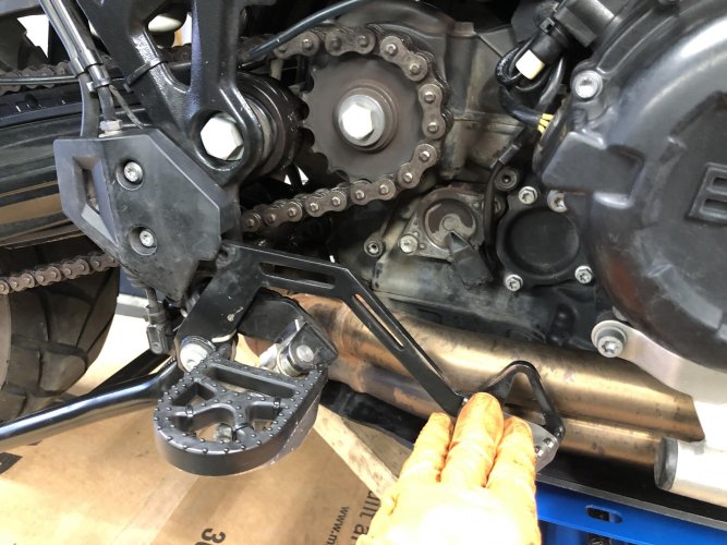

We can now torque the front sprocket bolt. The bolt needs to be coated with Loctite 243 (medium strength) before it gets tightened to 50 Newton-meters (36.9 foot pounds or 443 inch pounds). You can use the rear brake to hold the chain/sprockets from moving.

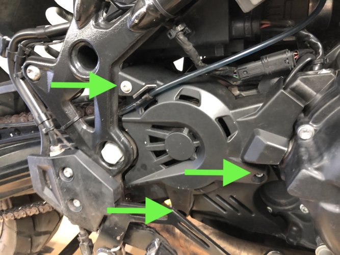

We can reinstall the front cover. Using your T25 Star (Torx bit), tighten the three bolts holding on the front cover (as indicated by the green arrows).
