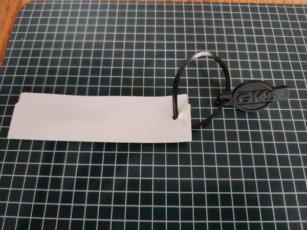

If you saved it, a new bike comes with a small plastic piece with a paper tag attached. The code is printed on the paper tag and plastic thing.
This is usually included in the package with the Rider Manual and Warranty book.
A dealer can also order a key using the bike VIN.
