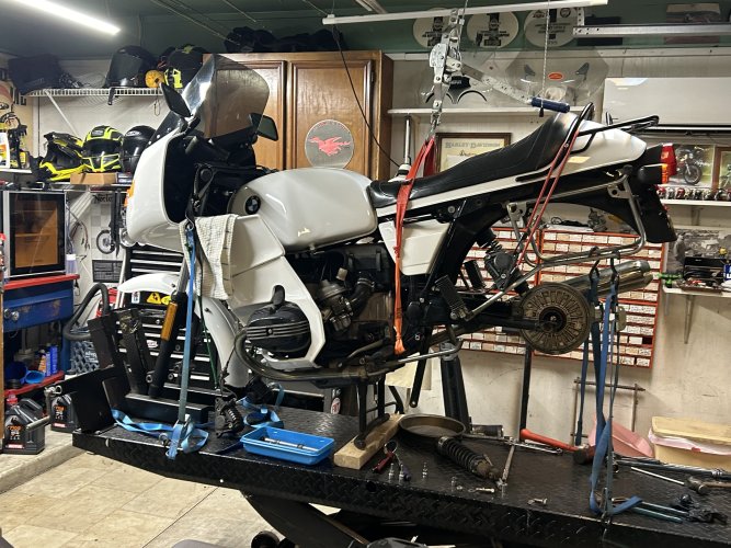

1983 R100 RS Project
Gas tank, try vinegar and some water with nuts and bolts, shaken, not stirred, sit for a couple of days, turned often. Buddy did it with KLR tank that was outside for years.forums.bmwmoa.org
