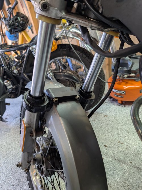

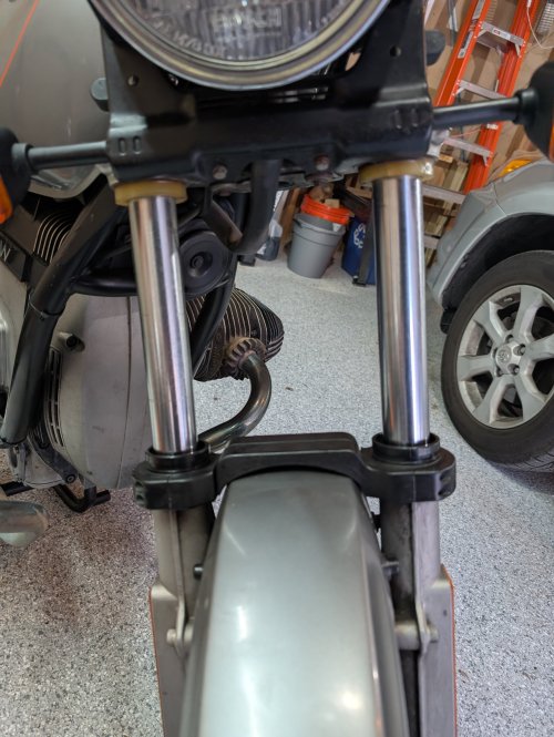

Front forks - I noticed on my machine it has a lower fork brace that lives above the front fender, in addition to the one that lives below the fender. Most pictures I see of original STs don't have this. Mine is an earlier 12/82 model so perhaps they changed production for later models. Any data or beliefs on if this is necessary or a preferred setup for handing? Its a bit ugly aesthetically, so why I ask. Also, I need to replace the fork boots (boots, not covers in this version). When taking off the fork tubes to install, any gotchas to watch out for on the install? I watched Brook's video on the R80ST charity rebuild, and he went through a very long process of making sure they were in parallel. My Honda of the same era is a remove and install with not much concern given to these things, so it is new to me.

Is the fork brace sort of a flat black bar about 7/8” thick, running from tube to tube? That maybe an old aftermarket TeleFix brace, or TeleFlex as we used to call them. The only OEM fork bracing on the ST was the fender mount itself.

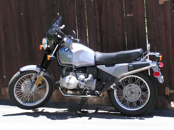

I’ve been riding a R80ST since fall of ‘83 since I unpacked it from the crate and set it up at the dealer where I worked. In fact I rode it this past Saturday. It has 138,000 plus on it and I’ve done all of the service on it since it was new. If you PM me I’ll help you where I can. What’s your location?
That is a very beautiful bike! I like the GS tank (?) that has been painted to the ST color scheme. Very clean and something to aspire towards. I'll put some pics below where I am currently at with mine.

Here are photos of the fork brace. It actually looks to be the same setup as Gary's bike pictured above as well.
View attachment 100698View attachment 100699
That’s a Telefix brace. It’s a non stock brace and period correct. I had one on my R100CS for a long time.
Very cool Honda. I have an ongoing 400F problem, but haven’t had one in about ten years.
Strong opinions based on your experience if it had a noticeable performance/handling impact?
I dunno. I had one on my R100RS when I was riding it hard two up with gear because the forks are kinda spindly. My CS is just used like a roadster on the hills around here, so I put RaceTech stuff and a billet top plate on it and ditched the telefix brace. I ride it lightly loaded solo, so I don't think I'm putting enough twisting force into the forks that a brace is all that necessary. The RS, on the other hand, would wind up the chassis and forks when it was loaded and I was trying to ride it hard on mountain roads.
I will say that the RaceTech stuff is a revelation in compliance. Less dive on braking. Far better compliance on cratered roads, especially on sharp edged bumps.
I've had both old school "San Jose BMW" style loop braces and a telefix on both my CB750F (1982) and my R100RS. I think it was a big help on the CB with that motor swinging around in the double cradle frame trying to twist the fork legs, but maybe less so on a casually ridden solo airhead that just rides on wiggly roads around the county.
