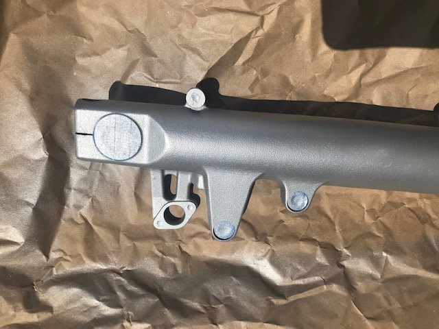

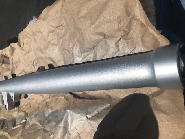

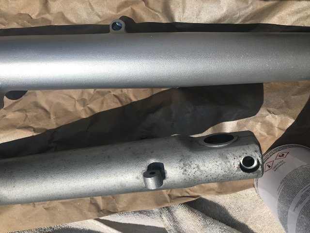

Prep was a through degreasing both prior to and after scuffing the entire external surface with a Medium ScotchBrite pad and 320 wet/dry on the worst parts, careful not to go deep enough to expose bare metal.
I really like these latest generation of Acrylic Lacquer aerosols.
The clear is a semi gloss/satin and virtually invisible after application.
