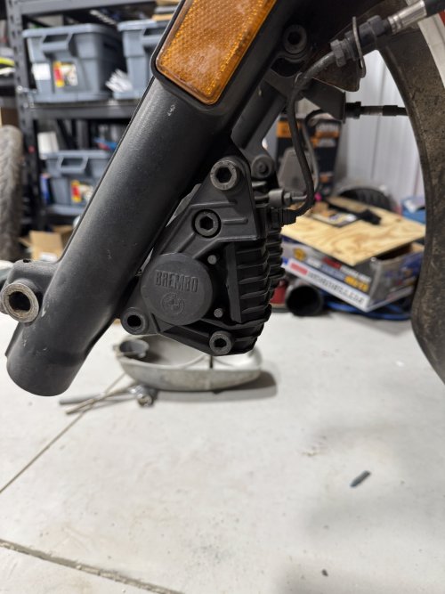

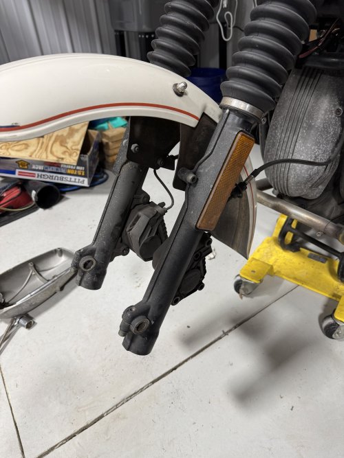

Hello all. I have a 1978 R100S. It is one of the bikes built for the European market(build month 06/1978 according to RealOEM) but then allegedly shipped to the US when the Euro economy tanked and Austria couldn't sell them. A previous owner has "upgraded" the front brakes to use the later Brembo brakes. This apparently was done by switching the fork lowers to the ones needed for the Brembo calipers. I want to install new brake pads and while I'm at it clean and freshen up the calipers. I see several kits offered at EME and other places. Since I don't have documentation from this upgrade to know what model/year lowers/calipers were used I'm looking for a way to determine which ones I have. Any guidance would be helpful.

The Brembo forks, brakes and such used for your conversion are limited to Brembo style forks and brake calipers found only on twin shock RT, RS or S bikes. So about 81 to 84 years. After 85, the front forks changed radically along with the Brembo brake calipers.
So if you check the fitment chart on EME or the BMW microfiche, you would want the Brembo repair kit to fit the 81 to 84 year bikes.
Good luck, St.

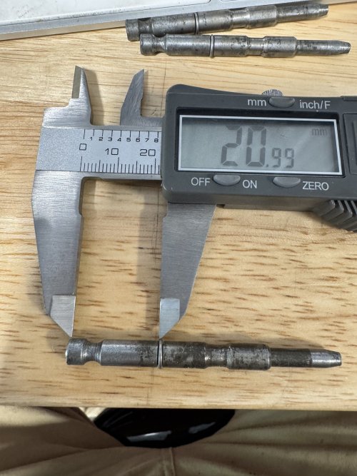

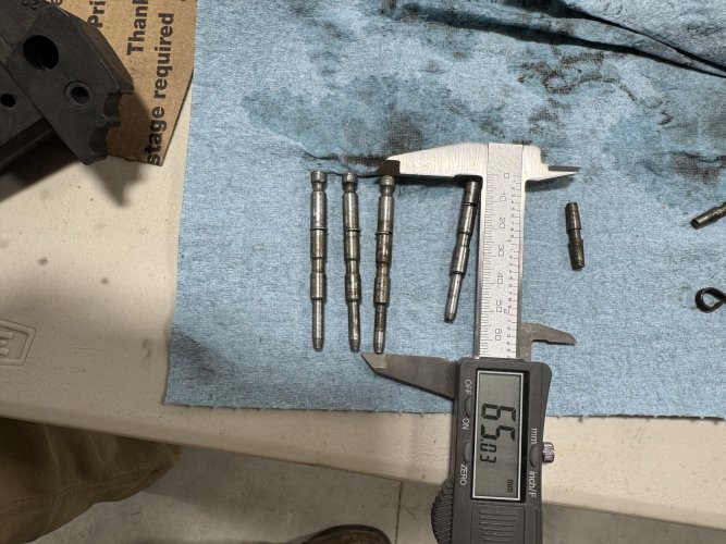

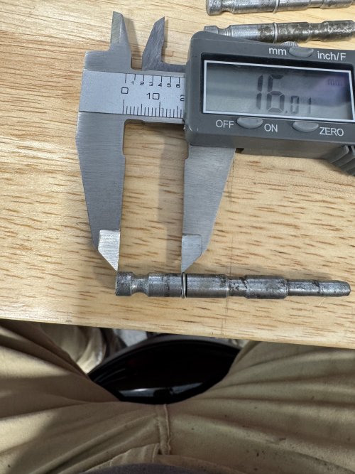

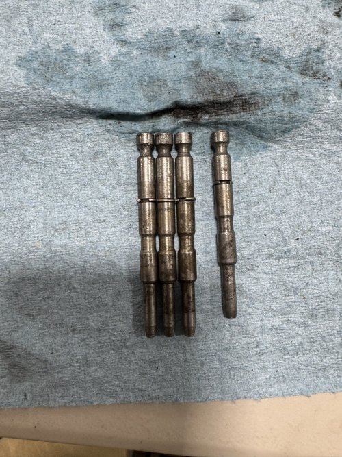

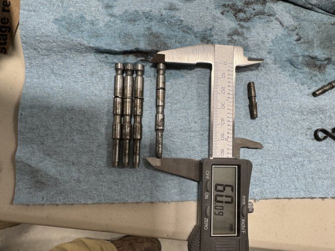

I was working on the calipers today and discovered I have a mis-matched set of pins. 3 X 65mm pins and 1 X 60mm pin. EME doesn't list the length of the pins in their kit. Max's fiche I only find 60mm pins. The difference is at the top of the pin. From the ring down the pins are the same. I guess I'll call EME and ask
