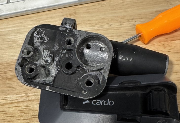

Hello again. I have previously posted for advice on caliper identification (mine are Brembo F08 it turns out) as I am renewing the front brakes on my 1978 R100S. A previous owner upgraded to newer Brembo brakes from the original ATE brakes, including a handlebar mounted master cylinder. The photo is my disassembled master cylinder after several bouts of cleaning in my Ultrasonic cleaner (PineSol) and various brushes and picks. My concern relates to the two holes visible in the photo. The left-most hole is larger than the right. There does appear to be a "pin" hole in the right hole but certainly not as large as the left-most hole.
As part of my preparation for the task I reviewed Brook Reams video on the 1983 R100RS which seems to have the same master cylinder.
At about 1 minute into this video the two holes in the MC are visible and both look like the left-most hole in my photo.
I am reluctant to try to enlarge the right-most hole. At least not before asking the Hive whether the holes seem correct? Or should they be similarly sized?

Thanks Steven. These holes are for inlet and outlet per Brook's video. That one on the right is very small. does it create (or maintain) some back pressure?
If the tiny hole is plugged the brakes will not fully release and the brakes may auto apply as the caliper heats up.
The hole closest to the outlet should be very small. That is the compensating port; it only has to allow fluid to equalize between the brake system and the reservoir when the lever is all the way back. There should be no maintained back pressure.

In case 9842's subtlety is lost on some of you, he's basically telling you what not to do. Don't run a clogged MC for years occasionally bleeding the excess backpressure. DO flush the brakes completely on a regular basis, and hopefully prevent the clogged MC problem in the first place.
Firm lever is generally good, but the lever becomes even firmer when the MC is clogged. Don't be fooled.
