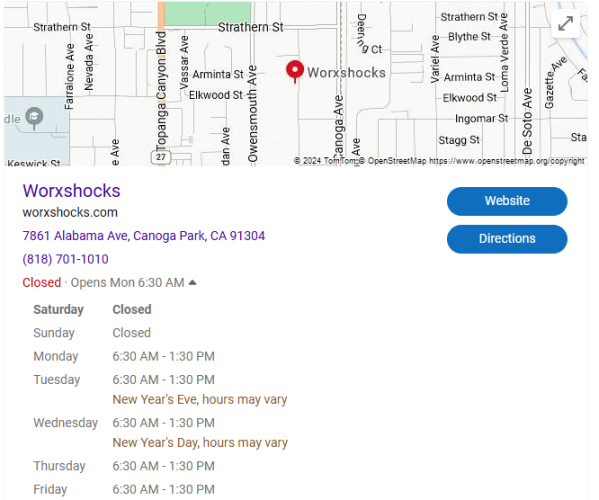

I have to say the Worx Shock web site may be the worst I have tried to use in many years. I can't find an address or phone number for the business. Anyone know where they are or a phone number for them?
sgtbill
Here's what Google has on them, which is consistent with the information on my invoice. If I remember correctly, I did need to leave messages on their phone number and they did get back to me.
Thanks Jeff. I'll give them a call this week.
