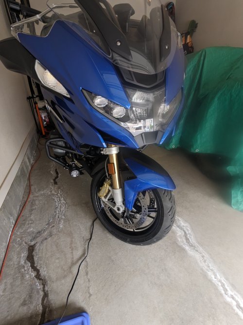

I am about to replace the front tire on my '22 R1250RT and the first step I performed was removal of the front (painted) tip of the front fender. I had hoped this would give me enough room to remove and roll the front tire away from the front of the bike once I jacked the bike up ever so slightly. Instead it seems that the remaining part of the front fender (see attached) extends a bit much and would require me to jack the bike up a good 6 inches to free it. I'm afraid by jacking the bike up that much it may cause the bike to tip over. So, I unfastened the two screws on the remaining fender part wiggled it but it was not cooperating. Asking for advice. Do I need to remove the remaining part of the front fender to remove the front tire? Don't want to break the fender.

I have the same bike 22R1250RT and change my own tires. You only need to remove the painted part of the fender and the brake calipers. Your calipers look attached. Yes you need to lift the front end up I do this with either weighting the rear of the bike with a 50# feed bag or scissor jack. What is the black handle attached?

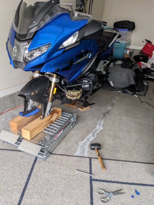

So I did what was suggested and had a buddy of mine put weight on the tail of the bike, first I added a little height to assist by first placing the center stand on blocks of wood. Then my buddy tipped it back and I had plenty of vertical height up front to free the front tire. Of course I then had to shore up the front once the tire was removed.

Job completed! Doing this myself saved me some cash and maybe just as importantly I learned more about my motorcycle doing the work myself. This is one big reason why I signed on to BMW MOA. I want to thank all who contributed.
