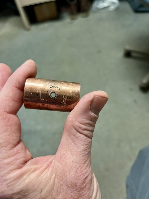

Thank you. The challenging part was drilling switchgear holes that need to be 180 degrees apart as there are bolts that go through the bars to secure them. I ended up using a copper tubing that was just a hair larger than 22mm internal diameter. The union had dimples 180 degrees from each other & I used it as a fixture on the bars drilling the holes from either side. I don’t have access to a drill press otherwise this would’ve been a much easier task.
