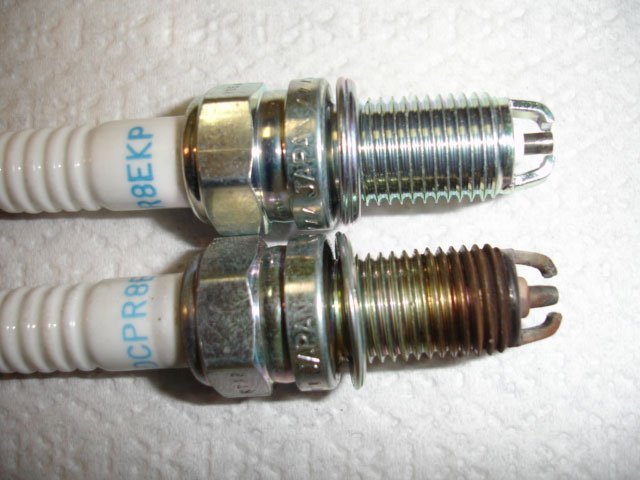

Changed some plugs on my 08 RT today that had been in the bike 26K miles.
They (OEM type NGK DCPR8EKC) were worn out of spec at an interval approx equal to the 40K kilometer recommended factory change interval though the bike was running and starting fine.
Spec gap is 0.8 - 1.0 mm and needs a wire gauge to measure due to shape of ground electrodes. The removed plugs measured 1.1 - 1.2 mm and both wear and appearance were similar for primary and secondary plugs.
The wear is primarily erosion of the center electrode to produce a taper. It is easily visible as a slightly tapered or conical appearance to the center electrode and actually does not require measurment to see.
I replaced the OEM type with DCPR8EKP - same as stock except with a platinum electrode instead of nickel. It will be interesting to see if they wear at a slower or same rate. They are a little cheaper than the nickel ones but have the same diameter center electrode- a bit unusual in that most platinum and iridium plugs have smaller diameter center electrodes than nickel equivalents.
Anyway- see photo below for a comparison of the worn OEM plug and the new replacement.
It seems that the factory interval for plug replacement is right on target for OEM types.

Great Photo! would it be possible to bend in the ground electrodes to cheat a few more miles out of these worn plugs?
If you were exceptionally unlucky you could have one of the electrodes break off, not common but it can happen. That would not be good. Plug is cheap compared to tires.
Rod
Adjusting those electrodes is a little fussy and as noted, I wouldn't want to take the chance on having one break afterward. They are heavier and stiffer than on many auto plugs so harder to adjust and the need for a wire gauge makes it slower. At what plugs cost, not worth it to me. Could be done as an emergency measure I suppose but you really don't want an electrode to end up in your motor. Have seen the results of this on race engines and it is not pretty.
