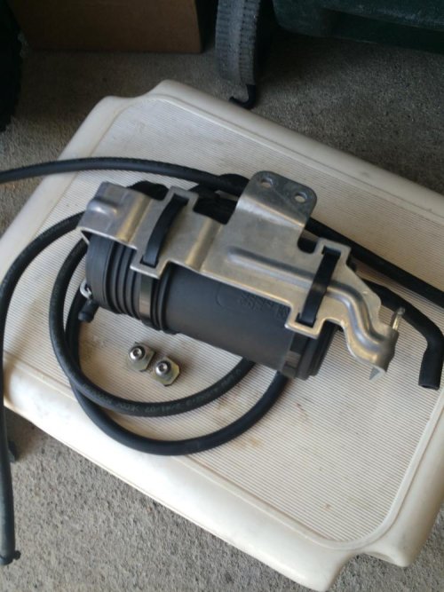

Canisterectomy
Two SMs at BMW dealers told me that my tank-filling technique might have caused issues with the charcoal canister which is part of evaporative-emissions system in US-destined BMWs. Both suggested I remove that piece from the system but also make sure that I don't put too much fuel in the tank.
I followed directions which I found on the MOA forum, and now have a canister-free system. FWIW, the canister (seen in attached photo) has three openings, all of which smelled very strongly of gasoline. I imagine this is normal. Following the removal, I filled up with Shell 93 and rode around for forty miles. I rode another fifty today, and the engine seems strong, and issue free.
At the least, I've eliminated a variable from the system. Thanks to all whom have offered their advice. As we said in my former employment: "Investigation continues..."
