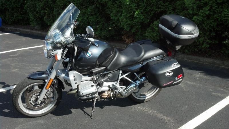

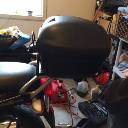

My "new to me" 1999 R1100R Special Edition arrived on Thursday and I had the Givi 635F, M3, and V46 ready to go on. One problem - the charcoal canister was in the way. So, I thought I would move it out of the way to see if it would fit properly if I were to remove the canister. Unfortunately, the alignment of the side cases was "off" because of the thickness of the 635F brackets. The side case mounts move out about 1/4", but the footpeg part that the side cases slide into do not move and so the alignment was bad and the side cases wouldn't fit. So it all went back already and I started searching again.

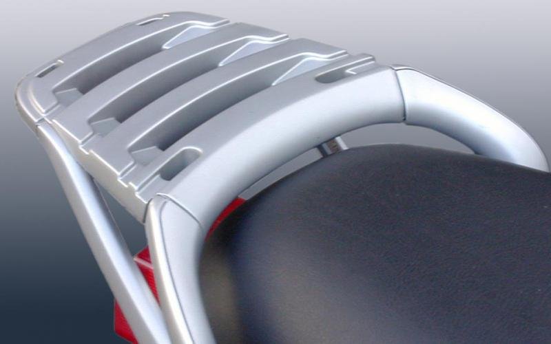

It appears there's a Hepco & Becker "rear rack" but I'm nervous it too might have a conflict with either the canister or the side case mounts. Awaiting email from them.

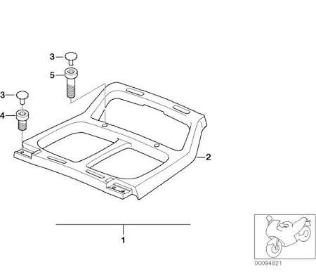

The only "sure thing" solution I can come up with is to find a used (or new) OEM rear luggage rack and then use either a Hepco & Becker or Givi top case with universal mount.
Anyone have any other ideas (or a used BMW OEM rear luggage rack)?
