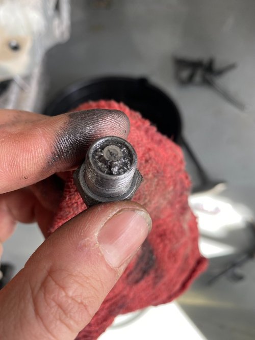

At first I'll admit that I didn't much like the bike. It was not in good shape and had a lot of neglected/deferred/incorrectly done maintenance. Despite being a single-spark bike originally, it had a twin-spark engine swapped into it at some point after the original one failed. You might wonder why one failed at such low mileage, but upon draining the transmission and final drive oil, it appeared that both of those had been changed on the first of never. Extremely dark oil in both of those and the final drive was very glittery.
