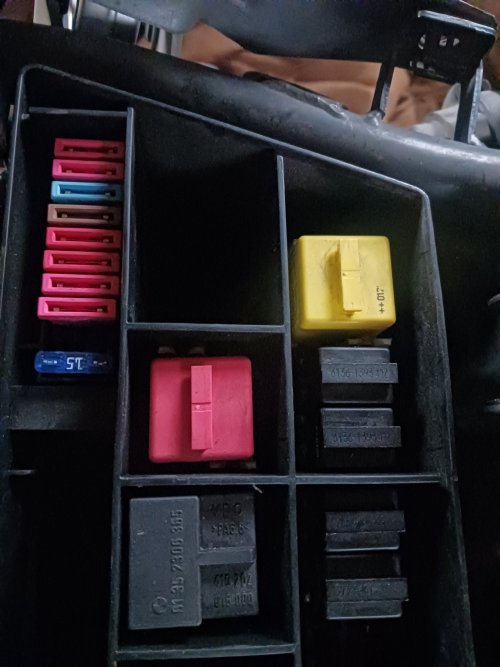

Hello I'm new to this so I hope I am doing it correctly I ride a 2002 BMW r1150 RT I was riding down the road the other day about 60 65 and my bike shut off I noticed I lost my fuel gauge and my oil temperature gauge all my other lights work the first time it cut off I dump the clutch it started back up I went up a ways to turn around so I could go back home and it shut off again and the fuel gauge and oil temperature gauge is still off has anyone ever had this problem I check all fuses got fire everywhere except for one and that is the red one

Welcome to the forum! Likely outside my league on this, but by red fuse are you talking about the larger on in the bottom center? What if you were to remove it and reinsert...maybe just help clean the terminals. Do you have the fuse puller that comes with things to pull these types of fuses?
Yes that will be the one I'm talking about I got fired to every other fuse in the Box except for that one I also noticed the bolt on my kickstand has broke but I don't think that's what made the gauges go out
