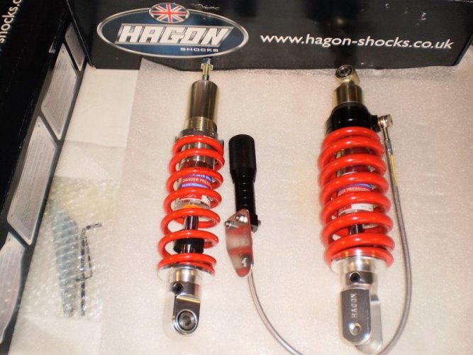

I bought a mildly used 97 R1100RT in 2010 with 26K miles for $5K. Now at 42K miles the shocks were way worn out. After comparing brands, I ordered a set of Hagon shocks from Dave Quinn Motorcycles. We talked on the phone and he asked many questions about weight and riding style to set me up right. Shocks arrived today; 4 days after placing order. Got front and rear shocks for the price of a rear Ohlins. Heading out to garage to install. I will follow-up with how the installation goes and how the ride feels.

I'd bet you'll have a great ride, very accurate dampening control, better handling overall, vastly reduced two up bottoming, better ride height control, a more "solid, accurate" feel of the bike going over bumps small and large. But especially over the smaller, more frequent bumps.
To me, it doesn't matter which aftermarket brand is chosen, be it Hagon, Wilbers, Ohlins, Hyperpro, Penske, etc, etc etc. What does matter is you are getting a much higher quality (than stock) internals for the shocks, better compression/rebound damping control/adjustment, spring rates chosen for the mid-range of YOUR wieght/loading/riding style, AND the ability to tune and rebuild the shocks when they do wear. I chose Wilbers at the time because I caught a great deal on the front shock on ebay, and then bought a Wilbers rear shock to match from my local dealer. Had that not happened I would have first chosen Hagon.

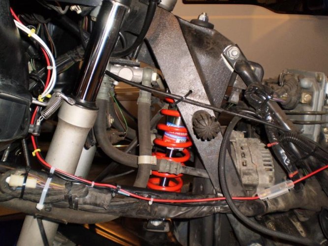

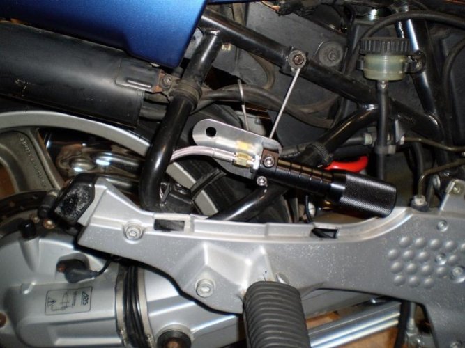

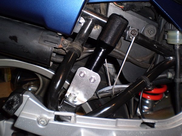

Installed the Hagon shocks tonight. Took about 3 hours including removing and installing the bodywork. Removed the fuel tank too. Glad I install Beemer Boneyard fuel quick disconnects last year when in replaced the fuel filter. Only had two issues. The upper front shock bushing was rotted and unusable. the Hagon shock did not come with a replacement. I was lucky I had spare shock bushes from a 99 chevy pickup in the garage that fit perfectly. Other issue was mounting the rear preload adjustor. I had to tywrap it in place for now. I will need to make an L-bracket to mount it properly. All in all it went well. Can't wait to go for a sport ride on Sat. to see how they feel.

Good on ya mate! Lucky you, you'll soon feel the revelation of what properly set up quality shocks will do for your ride, comfort, handling, precision and ability. I doubt I will ever own/ride a BMW on stock (crap) shocks anymore.
