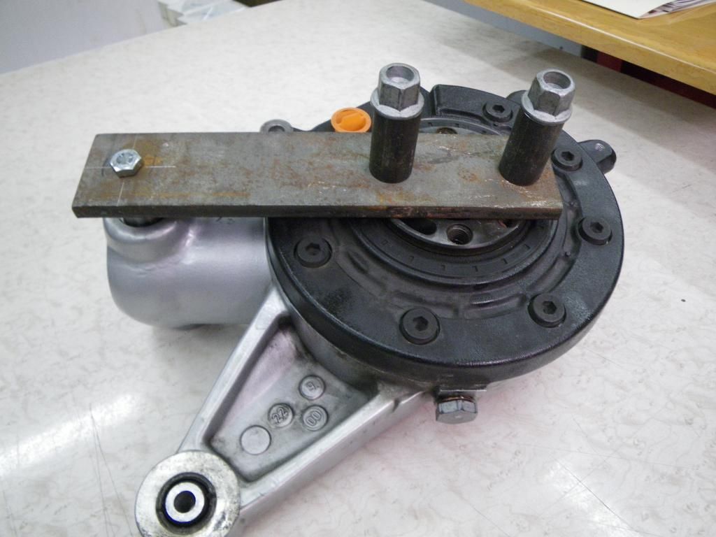

The jig below holds the pinion from turning when removing the hexnut as well holding the FD in a vise to remove the threaded ring.

I can see how the jig will be necessary to remove and torque the threaded ring. Can make that from bar stock and pipe nipples.

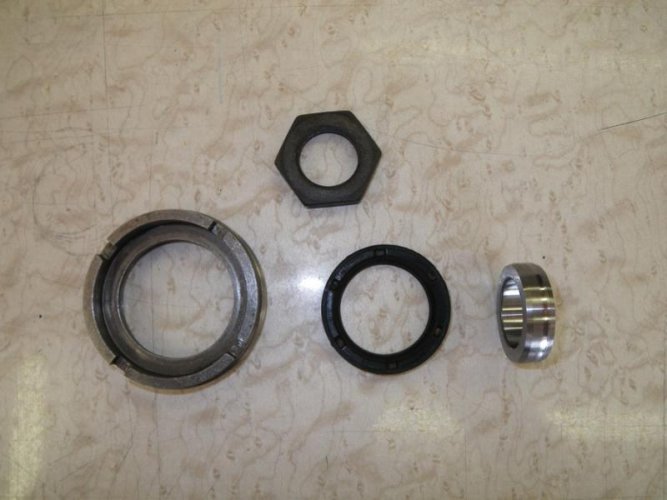

Saddleman, the "compression ring" is a static "spacer", correct?? Wear or deformation??

The compression ring is solid steel & does not compress. The compression ring turns inside the seal & can get a wear groove.
Parts in question. The compression ring in this case could be re-used
