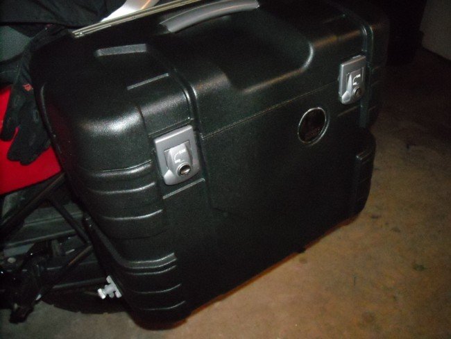

I just painted a set of Hepco Becker Gobi bags this week. They are plastic but the same idea. I used plastikote truck bed liner paint and it worked great. i tried the stuff from walmart and it was a disaster. Once i got the plastikote stuff it was great! Nice texture and great durability and easy to spray. Rough up the aluminum and probably prime it first and it should look great.
Oldhway, thanks for the example! They look great! This may be a good option...It looks like they are on a red/black GSA. Could you post an overall pic of the bike w/panniers? My GSA is r/b also...
:blush They are actually on my V-Strom. My RT came with standard system cases and I hated the look of the silver bags on the Strom. Haven't shot any photos of the whole bike yet but it is quite an improvement in appearance. I was able to do the whole job in a day since you only needed to wait about 10 minutes between coats. I couldn't believe how easily it went. Only time will tell how it holds up but with the texture to it, and the fact that it's made to line a pickup truck bed, I expect it to be very durable.
