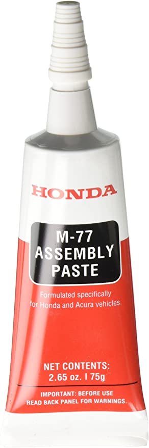

Honda M77 Assembly Paste
Honda M77 is of the best Moly Pastes on the market. I use it on my 2011 RT after being recommended by a BMW dealer in Denver. You can get it on Amazon for les than $18.

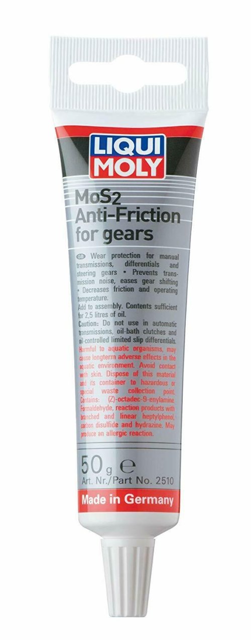

Reading the above, would this be an acceptable final drive gear oil additive? I thought adding moly to roller/ball bearings is a bad idea? The bearings skid instead of roll. I'm sure moly is good for the bevel gears though.
Yes it would be suitable. I have used a moly gear oil additive in every final drive and gear oil lubricated transmission on our bikes since Oak suggested it to me in 1984 or '85. That includes Voni's R1100RS with 412,000 miles.
As far as I know a moly additive in the proper concentration is not harmful to bearings. What is harmful to bearings is using gear oil that is too thick - ie too high a viscosity. The oil will wedge out ahead of the balls leaving insufficient lubricant between the balls and the races.
From what I remember and maybe I am wrong, Oak is a trained BMW technician as well as a materials engineer.
The Dow Corning M Gear Oil Additive as per their data sheet is to be used with non-synthetic gear lube which has never been an issue for me as I mixed it with Bel-Ray Gear Saver Hypoid Gear Oil 90 (now discontinued) and now Bel-Ray Gear Saver Hypoid Gear Oil 80W-90. I use them in my R100 GS and R1150 GS Adventure. As for my 2016 R1200 GSA LC, when I was on warranty, I used the BMW spec final drive lube...I do not need a manufacturer to start pointing fingers as to why something has failed.
When not loaded, bearings can skid, which is why they use a Belleville washer to load the angular contact bearings in my car's distributor. Not the case in my final drives on my GSes. When you stated "I thought", one has to careful; The Internet is the largest source of unconfirmed information. lol
By the way, as Paul stated, a thicker oil does not protect things better. I have read that advice on forums for years.

Thanks Gents. I'll add a percentage of this moly gear lube to my final drive oil. I'll continue to use the BMW gear lube and add this.
Global, just look for the Liqui Moly products on Amazon. Plenty of European sellers there and many will ship for free. This is where I bought this tube of moly gear lube - about 9 bucks with free shipping.
