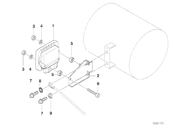

The most recent Airmail had an R100GS with a similar starting problem. Turned out to be a defective ignition control unit (ICU). Earlier ICU's (your vintage) had a "timing" problem and would give hard starting. Look for white or pink writing on the unit, newest ones are turquoise and OK. It's under the tank. Item #1 in the diagram.
