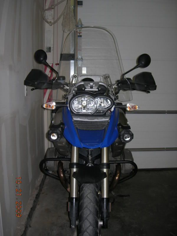

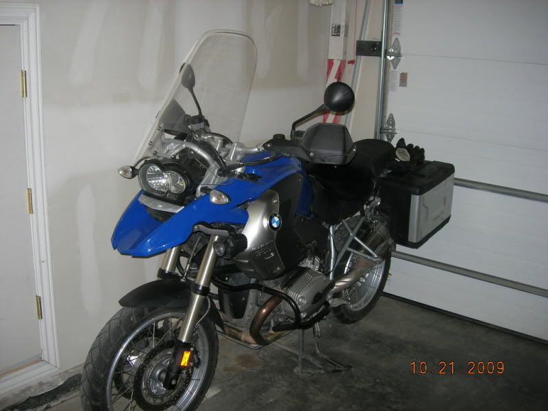

I've got an '08 1200GS too and had the tall OEM windscreen (I'm 6'4"). The buffeting was tolerable but the wind noise was very annoying. I just put a taller CalSci shield on it and it cleared nearly all the noise out. I can actually hear the engine now!
I went with the "large" size and it worked out great. Plus, it is a bargain at $240 compared to those $500+ aftermarket shields.
