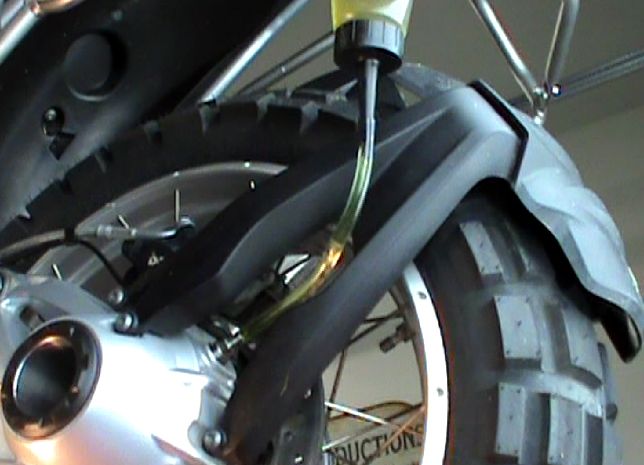

As mentioned above Jim VonBaden sells a bottle, hose and a metal fitting that screws into the fill hole on the final drive.
No chance of spilling with his setup.
You can see it on the ADV thread.
http://advrider.com/index.php?threads/bmw-final-drive-fill-tool.506278/
If you can't see the ADV thread, the tool is $35.

I use the same device I use for filling front forks. It is a typical gear oil bottle with the bottom cut off and a wire bail attached. It has vinyl tubing attached to the pointed spout and a pointed vacuum line connector in the other end. I hang the bottle, insert the tip into the fill hole, and pour the measured quantity of lubricant into the bottle. Then I have a cup of coffee while gravity does the work.
